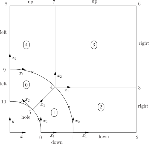

5.1.2 Mesh generation
The domain consists of four blocks, some of which have arc-shaped edges. The block structure for the part of the mesh in the x − y  \relax \special {t4ht= plane is shown in Figure 5.2. As already mentioned in section 2.1.1.1, all geometries are generated in 3 dimensions in OpenFOAM even if the case is to be as a 2 dimensional problem. Therefore a dimension of the block in the z  \relax \special {t4ht= direction has to be chosen; here, 0.5 m  \relax \special {t4ht= is selected. It does not affect the solution since the traction boundary condition is specified as a stress rather than a force, thereby making the solution independent of the cross-sectional area.
Figure 5.2: Block structure of the mesh for the plate with a hole.
The user should change into the plateHole case in the $FOAM_RUN/tutorials/stressAnalysis/solidDisplacementFoam directory and open the system/blockMeshDict file in an editor, as listed below

Until now, we have only specified straight edges in the geometries of previous tutorials but here we need to specify curved edges. These are specified under the edges keyword entry which is a list of non-straight edges. The syntax of each list entry begins with the type of curve, including arc, simpleSpline, polyLine etc., described further in User Guide section ??. In this example, all the edges are circular and so can be specified by the arc keyword entry. The following entries are the labels of the start and end vertices of the arc and a point vector through which the circular arc passes.
The blocks in this blockMeshDict do not all have the same orientation. As can be seen in Figure 5.2 the x2   \relax \special {t4ht= direction of block 0 is equivalent to the − x1   \relax \special {t4ht= direction for block 4. This means care must be taken when defining the number and distribution of cells in each block so that the cells match up at the block faces.
6 patches are defined: one for each side of the plate, one for the hole and one for the front and back planes. The left and down patches are both a symmetry plane. Since this is a geometric constraint, it is included in the definition of the mesh, rather than being purely a specification on the boundary condition of the fields. Therefore they are defined as such using a special symmetryPlane type as shown in the blockMeshDict.
The frontAndBack patch represents the plane which is ignored in a 2D case. Again this is a geometric constraint so is defined within the mesh, using the empty type as shown in the blockMeshDict. For further details of boundary types and geometric constraints, the user should refer to User Guide section ??.
The remaining patches are of the regular patch type. The mesh should be generated using blockMesh and can be viewed in paraFoam as described in section 2.1.2. It should appear as in Figure 5.3.

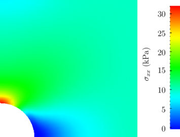

Post processing can be performed as in section 2.1.4. The solidDisplacementFoam solver outputs the stress field σ   \relax \special {t4ht= as a symmetric tensor field sigma. This is consistent with the way variables are usually represented in OpenFOAM solvers by the mathematical symbol by which they are represented; in the case of Greek symbols, the variable is named phonetically.
For post-processing individual scalar field components, σxx  \relax \special {t4ht=, σxy  \relax \special {t4ht= etc., can be generated by running the postProcess utility as before in section 2.1.5.7, this time on sigma:
    postProcess -func 'components(sigma)'
Components named sigmaxx, sigmaxy etc. are written to time directories of the case. The σxx  \relax \special {t4ht= stresses can be viewed in paraFoam as shown in Figure 5.4.
Figure 5.4: σxx  \relax \special {t4ht= stress field in the plate with hole.

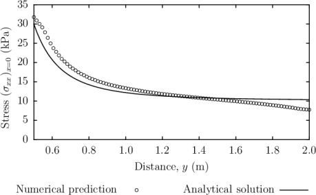

We would like to compare the analytical solution of Equation 5.1 to our solution. We therefore must output a set of data of σxx  \relax \special {t4ht= along the left edge symmetry plane of our domain. The user may generate the required graph data using the postProcess utility, using a sets function object. The utility can be driven from a user-supplied file located in the system directory, whose entries are summarised in User Guide Table ??. The sample line specified in sets is set between (0.0, 0.5,0.25)  \relax \special {t4ht= and (0.0, 2.0,0.25)  \relax \special {t4ht=, and the fields are specified in the fields list:
8
9singleGraph
10{
11    start   (0 0.5 0.25);
12    end     (0   2 0.25);
13    fields  (sigmaxx);
14
15    #includeEtc "caseDicts/postProcessing/graphs/sampleDict.cfg"

The writeFormat is raw 2 column format. The data is written into files within time subdirectories of a sets directory, e.g. the data at t = 100  \relax \special {t4ht= s is found within the file sets/100/leftPatch_sigmaxx.xy. In an application such as GnuPlot, one could type the following at the command prompt would be sufficient to plot both the numerical data and analytical solution:
    plot [0.5:2] [0:] 'sets/100/leftPatch_sigmaxx.xy',
        1e4*(1+(0.125/(x**2))+(0.09375/(x**4)))
An example plot is shown in Figure 5.5.
Figure 5.5: Normal stress along the vertical symmetry (σxx)x=0   \relax \special {t4ht=
