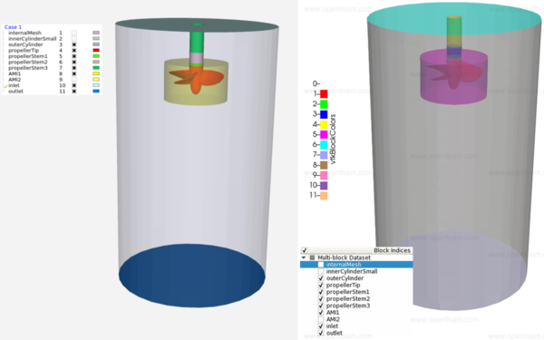

Improved data conversion to Ensight format
The foamToEnsight utility has been extended to include flexible handling of cellZones and to incorporate more functionality similar to foamToVTK. The foamToEnsightParts utility (which was serial only) is now redundant and hence removed.
Now, foamToEnsight
  • can handle multiple cellZones
  • additional support for point fields (as per foamToVTK)
  • additional -nearCellValue option (as per foamToVTK)
  • as before, can run in serial or in parallel
The newest foamToEnsight options:
Options Output
default Individual parts for cellZones, unzoned cells (internalMesh) and patches
-cellZones NAME/LIST Specify single or multiple cellZones to write
-no-cellZones Suppress writing any cellZones
-excludePatches NAME/LIST Exclude single or multiple patches (name or regex) from writing
-index NUM Starting index for consecutive number of Ensight data/files.
-nearCellValue Use zero-gradient cell values on patches
-no-mesh Suppress writing the geometry
-no-overwrite Suppress removal of existing EnSight output directory
-no-point-data Suppress conversion of pointFields, disable -nodeValues
The full list of options can be found in the online manual and/or in the OpenFOAM API guide
The improved cellZones functionality can be tested on using tutorial case with cellZones. After running foamToEnsight, users can visualise the case as shown in the figure below, where the various cell zones are highlighted in different colors. In ParaView, cellZones can be extracted from the Ensight format via the filter Extract block.
[Picture]
Propeller case processed with Ensight (left) and ParaView (right)

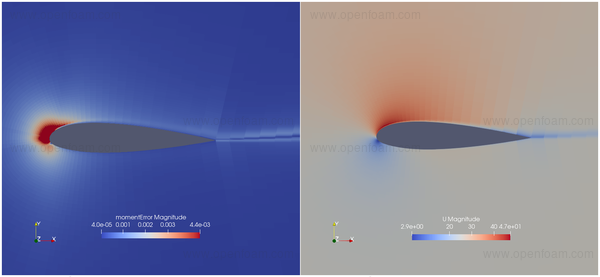

New momentum error function object
The new momentumError function object evaluates the error associated with the discretisation of the momentum equation solved in the top level solver, either based on settings in the controlDict or the command line via the postProcess option and utility.
Evaluations are performed per time step where the transient term is not included in the budget calculation. Therefore, the tool is only suitable for steady solvers.
The error is calculated using:
momentErr = divDevRhoReff() + fvc::div(phi, U) + fvc::grad(p)
where:
  • divDevRhoReff() is the turbulent momentum flux
  • fvc::div(phi, U) advection term
  • fvc::grad(p) pressure gradient
[Picture]

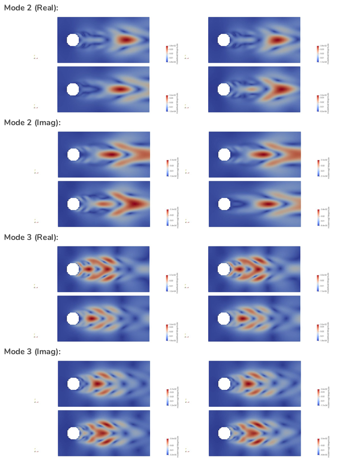

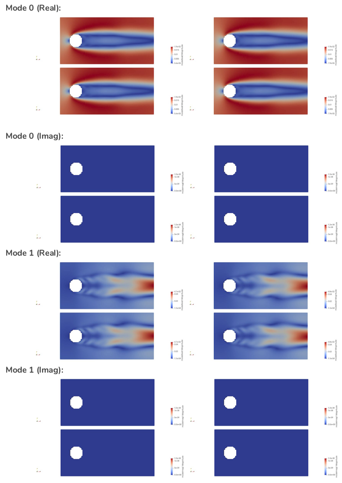

New dynamic mode decomposition (DMD) function object
Dynamic Mode Decomposition (DMD) is a data-driven, i.e. independent of the underlying physics, dimensionality reduction method that can be used to reveal and quantify dominant spatiotemporal-coherent structures from a given flow (or dataset) in the form of modes, and associated mode parameters, e.g. mode frequency and decay rate, so that dynamic features of the given flow may become interpretable, tractable, or even reproducible without computing the complete set of governing equations. An elegant and useful introduction to DMD theory is given by Brunton (2018).
This release includes a new DMD variant as a function object called Streaming Total Dynamic Mode Decomposition (STDMD) based on an algorithm developed by Kiewat (2019), Hemati et al. (2017), and Hemati et al. (2014).
Among other DMD variants, STDMD is presumed to provide the general DMD method capabilities alongside economised and feasible memory and CPU usage, by allowing incremental updates and data compression on orthonormal bases.
Prominent characteristics:
  • Parallel including the classical Gram-Schmidt procedure, and direct tall-skinny QR decomposition (except the eigendecomposition solver)
  • Templated input for which {vol,surface}<Type>Field can be input where <Type>=Scalar/Vector/SphericalTensor/SymmTensor/Tensor, e.g.volScalarField.
  • Data compression by an orthonormal basis compression is possible.
  • Three mode sorting algorithms, and various filtering entries are available to reveal the dominant modes.
Potential (known) caveats:
  • This STDMD release is the beta release; therefore, small-to-medium changes in input/output interfaces and internal structures should be expected in the next versions.
  • DMD is an active research area at the time of writing; therefore, there would be cases whereat oddities might be encountered.
  • Restart is currently not supported since intermediate writing of STDMD matrices are not supported due to the prohibitive computational costs.
  • Operations on boundary fields, e.g. wallShearStress, are currently not supported.
  • Usage by postProcess utility is not available.
A set of plots showing cross-sections of mode fields from a two-dimensional steady-inflow cylinder
verification test suite can be seen below. In each sub-figure the corresponding order is used: Left-top = MATLAB (using serial data); Left-bottom = OpenFOAM (serial); Right-top = MATLAB (using parallel data); Right-bottom = OpenFOAM (parallel/8-procs).
[Picture]
Real and imaginary mode-0 and mode-1
[Picture]
Real and imaginary mode-2 and mode-3
The minimum working example of this function object can be seen below:
