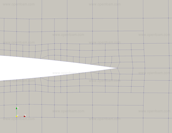

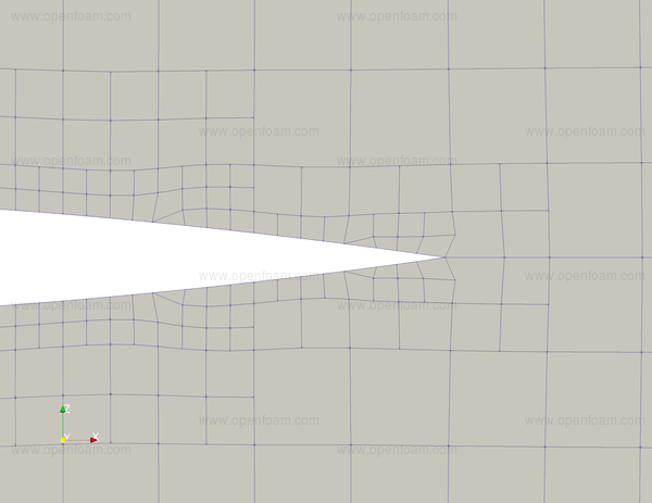

snappyHexMesh New directional refinement
snappyHexMesh now supports additional directional refinement inside refinementRegions. This is done through the optional keyword levelIncrement inside the refinementRegions dictionary. The mode keyword decides which side of the refinement geometry is refined. Any omni-directional refinement (through the level) keyword is performed first, followed by selectively splitting cells in a given direction. e.g.
refinementRegions
    wake
        mode        inside;
        // Dummy uniform refinement
        levels      ((10000 0));
        // Directional refinement
        //  - for all cells with uniform level 0-1
        //  - do one split in y and z direction. Note:the resulting mesh is
        //    no longer compatible with e.g. dynamic
        //    refinement/unrefinement.
        levelIncrement  (0 1 (0 1 1));
In below figures the effect of the additional refinement is shown on a simplified airfoil shape, without directional refinement:
[Picture]
and with directional refinement
[Picture]
The limitations are
  • the refinement is only in regions - there is no surface-based equivalent
  • the starting mesh has to be coordinate axis aligned (you can move it afterwards using e.g. transformPoints)
  • the resulting mesh will be incompatible with dynamic refinement/unrefinement.
