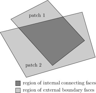

  • the faces of the master patch remain as originally defined, with all vertices in their original location;
  • the faces of the slave patch are projected onto the master patch where there is some separation between slave and master patch;
  • the location of any vertex of a slave face might be adjusted by blockMesh to eliminate any face edge that is shorter than a minimum tolerance;
  • if patches overlap as shown in Figure 4.6, each face that does not merge remains as an external face of the original patch, on which boundary conditions must then be applied;
  • if all the faces of a patch are merged, then the patch itself will contain no faces and is removed.
\relax \special {t4ht=
Figure 4.6: Merging overlapping patches
