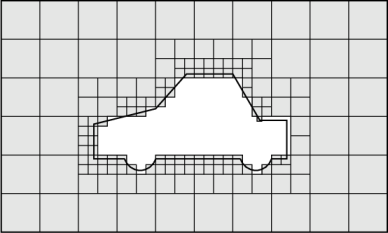

The splitting process begins with cells being selected according to specified edge features first within the domain as illustrated in Figure 4.10. The features list in the castellatedMeshControls sub-dictionary permits dictionary entries containing a name of an edgeMesh file and the level of refinement, e.g.:
features
        file "features.eMesh"; // file containing edge mesh
        level 2;               // level of refinement
The edgeMesh containing the features can be extracted from the STL geometry file using surfaceFeatureExtract, e.g.
    surfaceFeatureExtract -includedAngle 150 surface.stl features
Following feature refinement, cells are selected for splitting in the locality of specified surfaces as illustrated in Figure 4.11.
\relax \special {t4ht=
Figure 4.11: Cell splitting by surface in snappyHexMesh meshing process

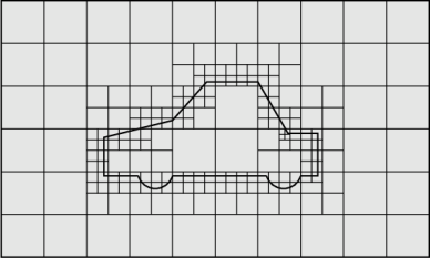

4.4.4 Cell removal
Once the feature and surface splitting is complete a process of cell removal begins. Cell removal requires one or more regions enclosed entirely by a bounding surface within the domain. The region in which cells are retained are simply identified by a location vector within that region, specified by the locationInMesh keyword in castellatedMeshControls. Cells are retained if, approximately speaking, 50% or more of their volume lies within the region. The remaining cells are removed accordingly as illustrated in Figure 4.12.

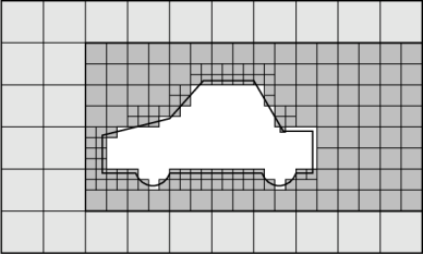

Figure 4.12: Cell removal in snappyHexMesh meshing process
